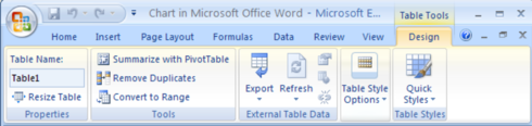

In Word for Windows, table Styles can be added through Quick Styles. This option can be found under Word's Table Tools tab.
To see this tab, you need to click inside any table so that the Table Tools tab is displayed above your Ribbon. Once the Table Tools tab is enabled, you will see the Design tab with the Quick Styles option under it.

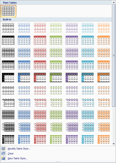

When choosing a table Style, note that the first item is meant to clear Styles, so by selecting it you get no Style format at all.
By clicking the bottom arrow on the Styles area, you will find more Styles available.
