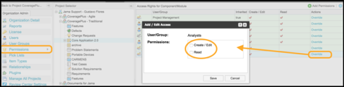

Although there is no automated way to toggle the visibility/invisibility of items for a certain group of users based on the item’s status, it is possible to do this through a manual process if you are an Organization Admin.
You can set items, sets, folders or components to be hidden from a certain User Group by removing the Read and Create/Edit rights via Admin > Permissions. As soon as the items reach your specified stage of approval, you can give permissions back to that User Group.

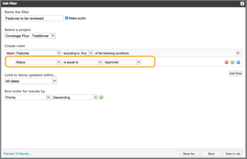

In order to keep track of the status changes to manually give permissions back to User Groups, and turn the items visible, a filter can be created to search for the items' status (e.g. Approved) and then be used to both monitor the changes and set the permissions.
