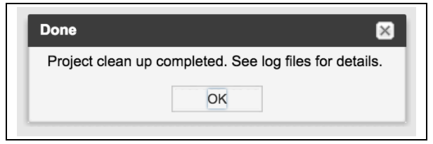

Cleaning up the project does not interfere with item history or the option to restore any deleted item; this is a background process. When it starts, it displays a quick message in the UI and, once completed, a second message is displayed.
Self-hosted customers can confirm the cleanup actions and the successful completion of the process in the server logs.
