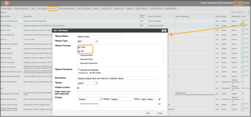

Although in general, it is possible to output BIRT- and Velocity-generated reports to different file formats (HTML, Word, PowerPoint, Excel, etc.), most Default Global Reports in Jama Software have not been designed to export to Excel and/or to Word. Here's a list of reports.
Although Jama Software comes preconfigured to output these reports in their compatible formats, System Admins (root user) sometimes modify these options in the Reports tab of the root menu. Please note that modifying these reports from their default settings may have unpredictable results and is not supported.
Examples of export errors associated with a wrong format setup are: "Error: java.lang.RuntimeException: Can't render report." and "The file is corrupt and cannot be opened." Please note that a misconfigured report is not the only scenario where these error messages can occur. If you are encountering these error messages and have not modified the report from the default settings, please contact Support for further assistance.

4. Do you have admin permissions? We should check the settings via Admin > Reports > Test Plan with Test Case Steps > Edit (a screenshot would be best)

What issue are you encountering, Victoria? The gist of this article is that we do not recommend and cannot support adding report output types to the default global reports. Doing so may prompt the error message. What report prompts this error to occur? The first step would be looking at the relevant user guide page linked by Carmen and making sure that no other report types were added, and if they were, to uncheck those boxes.
