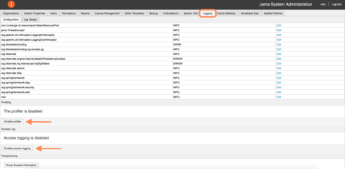

Additional content will be captured in the contour.log for every log entry as soon as Profiler and Access logging are enabled. As soon as you are done collecting the needed logs you should turn them off, otherwise logs will be growing really fast along with performance issues.
Both these features can be enabled in the root menu > Logging by the System Admin.
