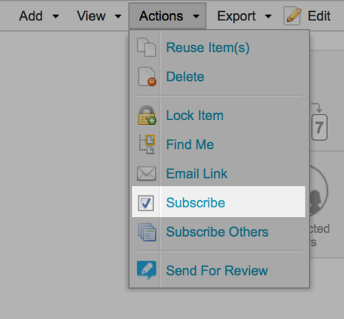

As a User, you can subscribe to email notifications through the menu Actions > Subscribe. A check box will show up to indicate if a subscription is already enabled.
If Manage Project permissions have been granted by the Org. Administrator, you can also send out notifications for other users, through the menu Actions > Subscribe Others.

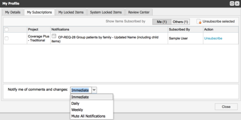

You are then able to see and modify the items you are subscribed to by accessing My Profile > My Subscriptions tab.
By default, the Immediate notifications option is set but you can change this behavior to Daily, Weekly or Mute All Notifications. You can also Unsubscribe your notifications here.
Additionally, you can Mute notifications assigned by others on Show Items subscribed by > Others tab, unless that ability has been disabled by the Org. Administrator.

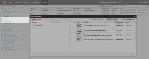

Both Project administrators and Org. Administrators can consult and remove subscriptions assigned by them, from the Edit Subscriptions window, under the Users or User Groups tabs.
