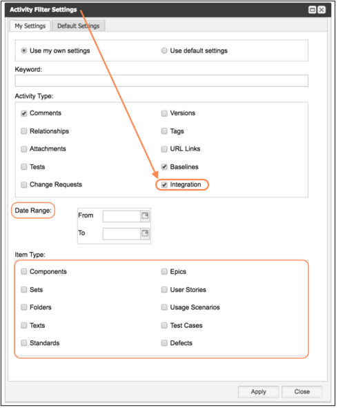

You can troubleshoot synchronization failures by tracking integration records in your project’s Activity Stream. You will need to configure your Activity Stream View for this, which can be done by opening the Activity Filter Settings in the top right Cog in the Activity Stream.
In the Activity Filter Settings you need to select the Integration in the activity types for this information to be displayed. You can also chose to filter by date range and specific Item Types in your view.

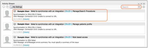

You will now see success or failure messages in the Activity Stream each time an item is synced. Users can use the Search field to look for specific item information, or use a string like "failed to synchronize" to sort for all failed syncs.
These activity records contain details about the synchronization failure, pointing to its cause.
