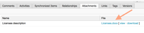

When uploading an attachment to Jama Software the file should only show its name.
However, if you use Internet Explorer, the file name may show a full path instead.
