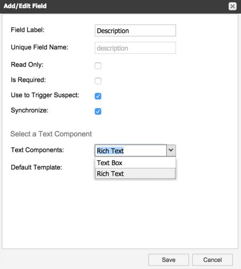

Roundtrip exports may contain HTML tags. This depends on the field's configuration, which can be set either as a Text Box or as Rich Text.
When exporting using the Excel Export for Roundtrip report, fields set as Text Box will show plain text.
Using the same report, fields that are set as Rich Text will show text mixed with HTML tags, since Excel cannot render HTML markup.
This happens only in the Excel Export for Roundtrip Report. This report exports the HTML markup to mirror the fields in the state they are in when exported, so it is possible to import them back to Jama Software with the same formatting, text, and tables.
