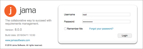

The first thing you will need to do when getting your backup is to log into your instance as a root user.

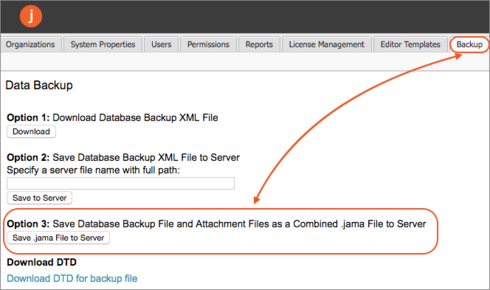

On the Backup tab, select the option Save Database Backup File and Attachment Files as a Combined .jama File to Server.
When you select the Save .jama File to Server button, you are asked to confirm that you wish to take a backup.
Once you confirm, you will see a message showing you the backup name and location. The amount of time a backup takes depends on the size of your dataset and the accompanying data folders. The file will appear in /data/contour/backup​ when complete.
