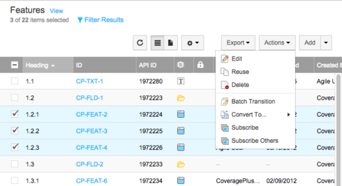

For the rest of this article, screenshots shown will be from Jama 2015.1. As an example of how to edit multiple items in Jama 2015.1 and later, select four items in the list view where you would like to change the assigned user and the release.
Select Actions > Edit.

The process of performing a Batch Transition looks very similar to editing multiple items. First, you select the items in the list view you want to transition and select Actions > Batch Transition.
