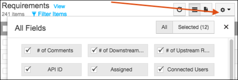

  • On the vVew pane, select List View.
  • Configure the List View and add all pertinent fields.
  • Select Export to Excel in the export drop down.
  • Repeat the process for each set of items you want to export.

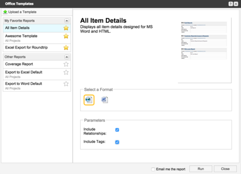

  • Select Office Templates in the Export drop-down.
  • Select All Item Details, tick the relationships and tags, if needed. Select Run.
