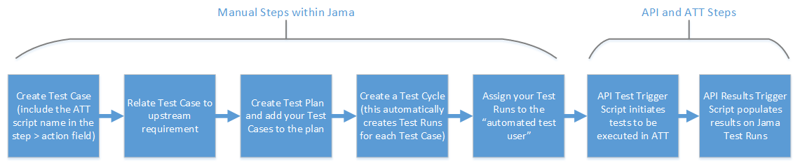

Functional Flow
Leveraging this approach allows Jama test cases to be pointed at automated test scripts in your ATT. Once these test cases are manually assigned to a test plan and put in a test cycle to be run, the test run is assigned to an “Automated Test User”. A script can find these test runs using Jama’s API and can notify your ATT to execute the tests and retrieve the results. The results are parsed and updated through the API and appear in Jama just as if they were executed manually within Jama’s test center.

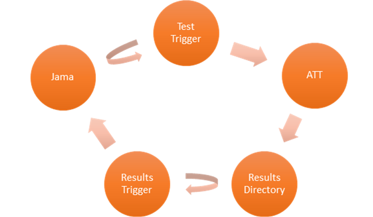

Technical Flow
Sample Approach #2 – Automated Testing Tool Initiated Tests
The Test Trigger script checks Jama for any test runs that are assigned to the automated test user.
  1. The Test Trigger script locks the test run and initiates the test execution in the ATT.
  2. The ATT places the results in a specified location.
  3. The Results Trigger script find and parses those results.
  4. The Results Trigger script updates the test run and unlocks it.

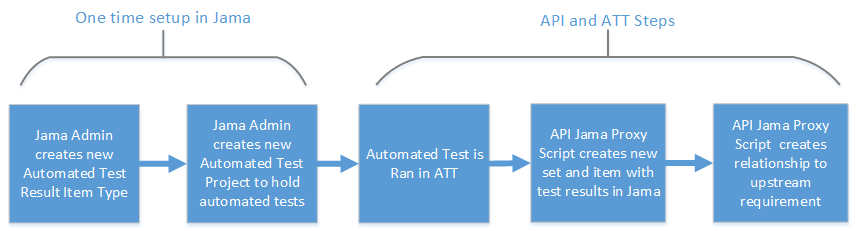

Functional Flow
In this approach your Jama Admin will create a new item type in Jama that represents your automated test results.  This item type should be included in your relationship rule and contain a name, description and status field at a minimum.  Your ATT will be used to trigger all automatic testing and the Jama API will be used to bring those results into your project AND to relate those results to the upstream requirements they are testing.
Assumptions:
  • Unique Jama ID (document key) of the satisfied requirement is available to test that’s satisfying it.
  • Jama Admin is available for  creating the necessary item type
  • Jama business and test leads should fully understand managing data in Jama.
  • Developers writing API scripts understand Jama and Jama data structure in detail
  • Automated test scripts are written, managed and executed in automated testing tool
  • Amount of test results being brought into Jama should not exceed performance recommendations (teams can manually archive or delete projects at specific intervals to maintain the appropriate amount of data in Jama)
Technical Implementation Details
Use the script at GitHub.com/JamaSoftware/Automated-Testing as a starting point for this approach. You’ll need some information from your Jama configuration to configure the script:
  • The API ID of the set item type.  This is a system-defined item type.
  • The API ID of the test results item type.  This is the new item type created for this approach.
  • The API ID of the project that will hold the test results.
  • The unique name of the field containing the Pass/Fail picklist in the test results item type.
  • The API IDs of the ‘pass’ and ‘fail’ options in the above picklist.
Technical Flow
  1. The ATT executes the Jama Proxy script when it’s done running a test.
  2. The Jama Proxy script receives:
    1. The document key of the satisfied requirement
    2. Any information that should be included in the test result item’s description
    3. The results of the test
  3. The Jama Proxy script adds the item to Jama.
  4. A relationship is established between the new test result item and the satisfied requirement
