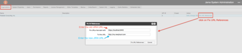

Login as user "root" to Jama. Under "Organizations" tab which is the default page when you login as root, click on the "Fix URL References" link. On the window that opens, enter the old JIRA URL on the top text box and the new JIRA URL on the bottom one. Click on the Fix URL References button and Jama will update all the JIRA URLs in all the items that are synced to JIRA.
