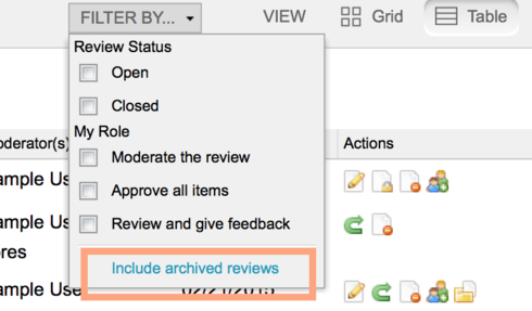

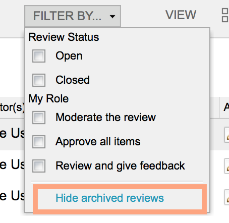

Only closed Reviews can be archived. Moderators or Review Center Administrators can perform this action, which removes the review from the primary view. Administrators have an extra Review Administration view by selecting Filter by > Include Archived Reviews.
To include the archived Reviews in a filter's results, the "Include archived Reviews" link must be clicked in the Filter's menu. All its subsequent filters will then include archived Reviews. To remove archived Reviews from a filter's results, the "Hide archived Reviews" option must be selected so they won't show up in the results.
