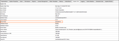

The location of contour home can be found when logged into Jama as the root user under the System Info tab.

Since this is a new environment, even if you are using a copy of the original contour home, Jama must know where to find the directory.
Start the Jama instance on your test environment and walk through the setup process. Once you get to 'Set Jama Configuration Location,' enter the location of contour home.
Note: It is very important that you enter the correct location in this step. Otherwise, Jama will create a brand new contour home.

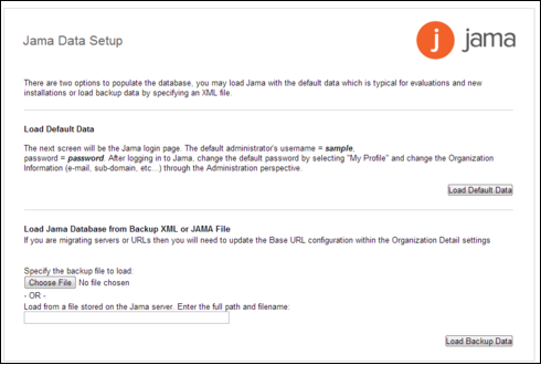

Populating the test environment with an XML backup
If you used an XML backup, you will need to create a blank database for the data to be loaded into. Once you get to the "Populate Database" section of the setup, you will be prompted to populate the database or load default data.
Enter the full path to the XML file in the second input field and select Load Backup Data.
