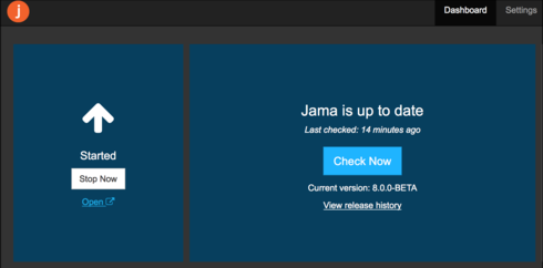

While Jama is running, navigate to the Replicated Admin Console and select Stop Now in the upper left-hand widget. This will stop Jama.

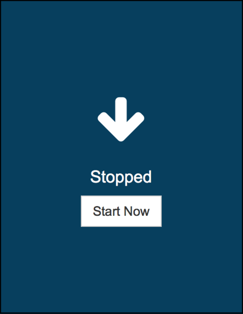

Once Jama has stopped, the widget will update to say that Jama is stopped. To start Jama back up, select Start Now.
Jama will run through the startup process, which can be tracked in the widget.
Once startup is complete, you will be able to navigate back to Jama.
