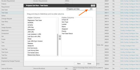

When evaluating test cases, it is usually desired to add in the Steps field; however, this guide can be applied to any item type and just about any field for Jama.
From Administration > Item Types > [Item Type] > Configure View, click drop-down menu that reads "Projects List View" and change to "Review Center Reading View."
Drag the fields you need to add (such as Steps) to the Visible column. Save!
Notes
  • If you'd like an expanded view for the item view, change the drop-down to "Review Center Single Item View" and pull in desired fields
  • Name and Description are always required; do not remove these fields or move any fields above them
  • Heading as a field currently does not show any data, but most reviews will show the heading to the left of the name of an item
