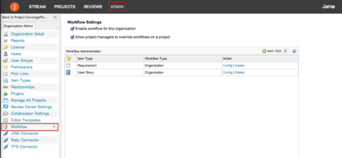

To set up workflow, select the "Admin" tab, and navigate to the "Workflow" option under the Organization tab.
From this main page, you can access the settings for Workflow, which include enabling the functionality for the Organization, and permission for Project Managers to override a workflow within a project. A list of currently active workflows is displayed beneath these settings.

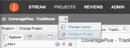

Any Workflow created at the Organization level will be available to every project within that Organization. If the "Allow Project Managers to override workflows on a project" box is checked, users with Manage Project permissions will be able to edit Workflows at the Project level to better suit their needs. To access Workflow from a project level, click on the Project panel in the "Admin" tab.
This will open a new list of settings. Select the "Workflow" tab to see a menu of active Workflows similar to the one located in the Admin Section. By clicking "Override", the Project Manager can make changes to but not delete the Workflow.
