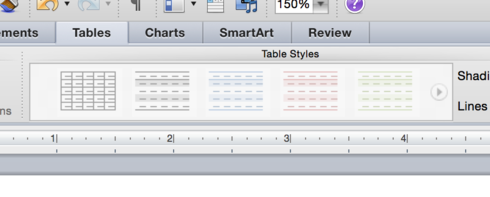

Additionally, the Rich Text Editor in Jama is best compatible when using a "Table Style" within Word and Excel.
This is recommended for when you are importing tables that are a part of the item's description; it is not necessary if you are importing tables or rows as individual items.

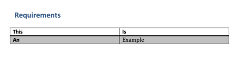

When you are importing tables as a part of the item's description, there is no need to map the table. Jama will simply add the table to the description of your item in Jama. To illustrate this, a Word document with a table such as this:
Using "Descriptions may include tables" option:

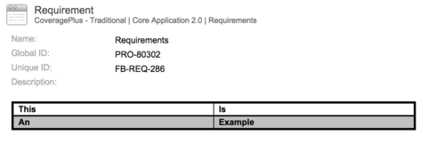

Will look like this in Jama:
The table is editable within the description.

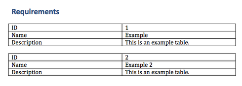

Mapping each table as an individual item:
Your Word document will look similar to this:
Notice that the left columns are the item fields, while the right columns contain field values. No special formatting to the item field is necessary, however many of our users like to highlight or bold the font in them to help distinguish one from the other.

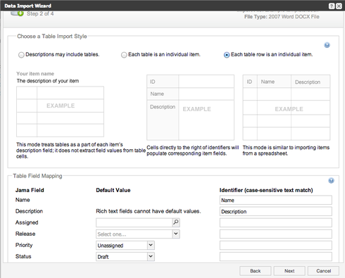

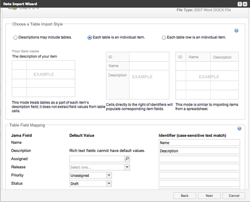

Import the document by right-clicking the set or component you would like it to import to, or through the Project > Import option.  Follow the normal import instructions, until Step 2. This will be where you can specify which table format you would like to use. After selecting the second table, a field mapping option will appear at the bottom of the pop-up window. If you have mapped Excel spreadsheets before, this process will look very similar.

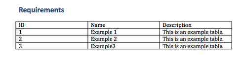

Treating Each Row as an Individual Item  Tables can also be formatted to import multiple, individual items. An example of this is below:
Similar to an Excel import, the top row of the table has item fields you'd like to have imported, such as ID, Name, and Description.
Select the third Table Import Style for this format. Similar to importing tables as individual items, you will have to map the fields of your table, as we have done in the example below:
If you have successfully imported this document, the items will appear like this in your Project Tree:
If you open one of the items you imported, the information you included in the table (such as description) will be included in the item details.
