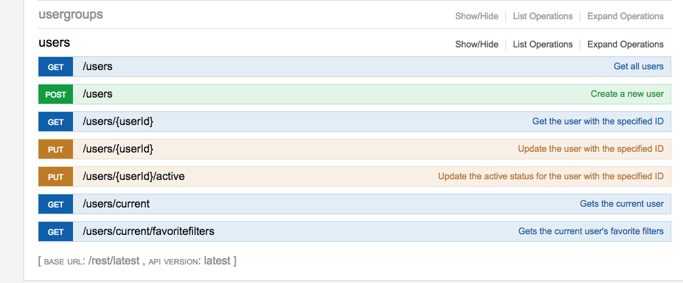

2. Use Swagger to create a new API only user:
Log into Jama and navigate to Swagger. This can be done by changing the URL to: <BaseURL>/api-docs/
At the bottom of the page expand the users tab by clicking on "users" then click on "Expand Operations" to display the available API calls.
Select “Create new user”.
a) Click in the example view field on the right to populate the body field on the left
b) Fill out the body field with the information for the API user. Note: you will not be able to reset the password for this user through the API after creation.
c) Select “Try it now”
This creates a user that does not have SAML enabled and can use Basic Auth to authenticate with the REST API. Use this user account to interact with the REST API. More information on the REST API can be found here.
