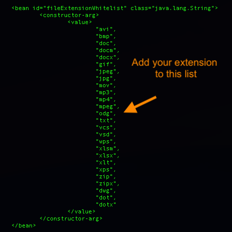

  2. Search for the following line: <bean id="fileExtensionWhitelist" class="java.lang.String"> in the contour-service-attachment.xml file.
  3. Add the new file extension to the existing whitelist in between the <value></value> tags.
