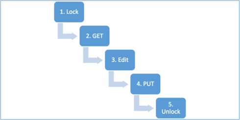

The basic workflow for editing an item in Jama using the REST API involves 5 steps.  Before you begin you need the item’s ID so you can lock it.  Since you intend to edit the item, you’ve probably already gotten its ID and stored it somewhere.
CAUTION:  PUT’s definition requires that it create or replace a resource.  Any data not supplied in the PUT request will not exist in the item after the PUT completes--even if it existed before.  The specification of PUT can be found at https://tools.ietf.org/html/rfc7231#section-4.3.4.
1. Lock the item to be edited, otherwise there’s a small chance that someone can make changes to the item while you are editing it.  If someone else has locked the item, your attempt to lock it may fail.

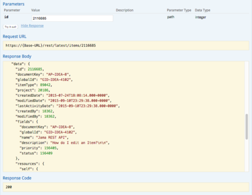

2. Now GET the item you just locked.

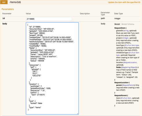

3. Copy and paste the “data” object into the PUT request and edit the “description” field.

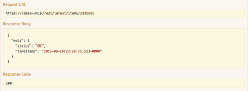

4. When you make the put request the entire resource is replaced with this new data object.
5. Now unlock the item and the edit is complete.

There are some situations where you need to remove certain read-only fields from the PUT request body.  In most cases the system can tell that the data is the same and lets the PUT go through, but sometimes (usually with dates) it can't tell that they're the same.  I've seen this most often with test runs.

Thanks Grant. I found that I must enter the old fields as well and not only the field I want to change ("Name", for example), else PUT deletes them.

I found that in order to do a PUT for an item, I had to remove the createdDate and modifiedDate fields (from GET results) as I was getting the same error.
Also, when using the bare minimum data for a PUT, I had to include the parent item which the PUT document says is optional...
"location": {"parent": {"item": 31037711}},
"fields": {"name": "Updated from REST"}
This worked!
