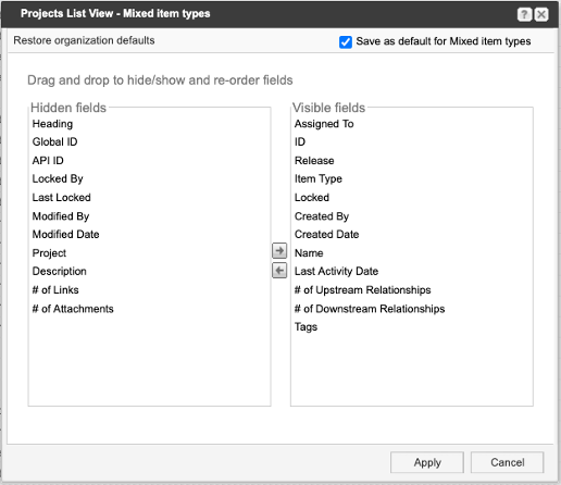

Coming soon to the 8.54 Cloud release, we have added some new functionality to what fields you can view in Baselines.
Prior to the 8.54 cloud release the baseline column toggler, which adds the fields only to list view, looked like this and only had these fields available.
What Has Changed?
The new baseline column toggler will allow you to add fields to both the baseline list and reading views. The fields you add to your reading view will work independently from the fields you add to your list view. The fields include custom and standard fields, for example you will now be able to see ‘Status’ if you have workflow enabled.
The table below captures what fields will be available or hidden in the "column toggler" in the new baseline list and reading views.
