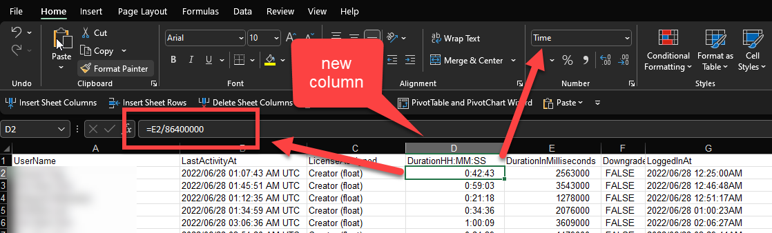

- Insert a new column to calculate the Duration in Milliseconds into a HH:MM:SS format
- Place your cursor in the second row of the new column and enter the following formula: =DurationInMilliseconds/86400000
- Copy the formula down the entire column
- Highlight the column and set the cell format to Time as hh:mm:ss

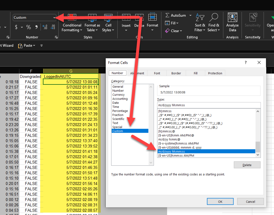

- Highlight the entire column > select the dropdown to format the cell and select More Number Formats... > select the Category 'Custom' and choose the m/d/yyyy hh:mm:ss option > select OK

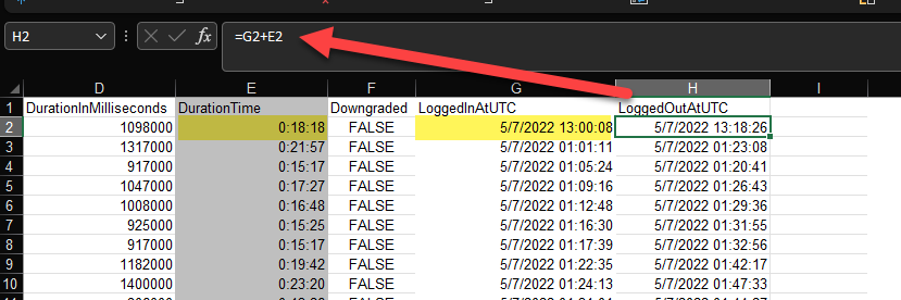

- Calculate the Logged Out time by adding the LoggedInAtUTC time to the Duration
- Create a new column next to the LoggedInAtUTC column and label it 'LoggedOutAtUTC'
- Enter the formula: =LoggedInAtUTC+DurationTime - in the example shown this is =G2+E2
- Copy the formula down the remainder of the column

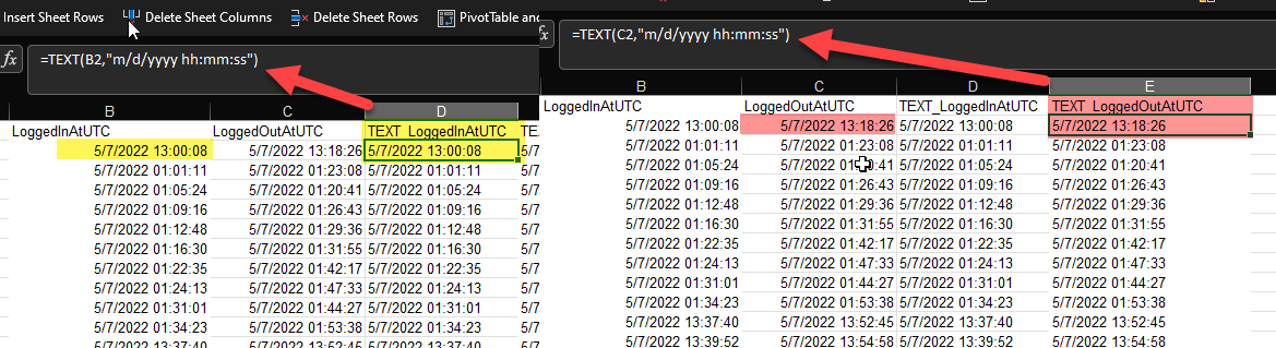

- Convert the LoggedInAtUTC and the LoggedOutAtUTC columns into text so that Excel may do the correct COUNTIF function calculations
- In the next empty column create a label 'TEXT_LoggedInAtUTC' -- in this example, this is column D
- In the next empty column create a label 'TEXT_LoggedOutAtUTC' -- in this example this is column E
- With your cursor in the first empty cell under TEXT_LoggedInAtUTC enter the following formula
- =TEXT('TEXT_LoggedInAtUTC',"m/d/yyyy hh:mm:ss") -- in this example, the formula is =TEXT(B2,"m/d/yyyy hh:mm:ss")
- Repeat the formula for the TEXT_LoggedOutAtUTC column -- in this example, the formual is =TEXT(C2,"m/d/yyyy hh:mm:ss")
- Copy the formual down the remainder of the column

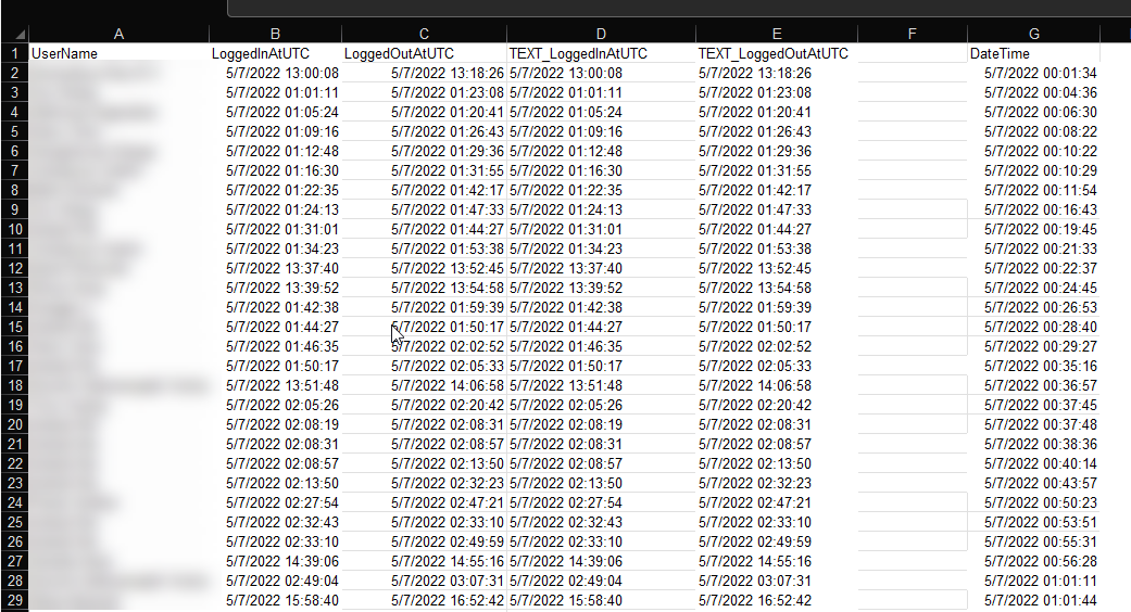

- Your worksheet should resemble the example pictured below at this point

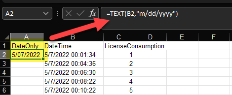

- Insert a column before the DateTime column and label it 'DateOnly'
- In the first cell after the label, enter the following formula =TEXT(DateTime,"m/dd/yyyy") --- In this example the formula is =TEXT(B2,"m/dd/yyyy")
- Copy the formula down the DateOnly column
- Highlight the entire DateOnly column > Copy the data > Paste the values only (this will remove the formula so that we can remove the DateTime column for a cleaner worksheet)

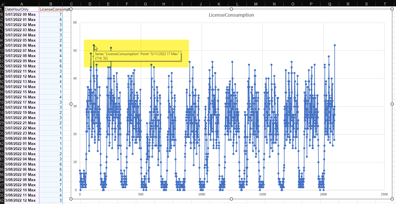

- In order to better see the peak usage, create a chart from the MAX values as follows:
- With Outline 2 selected showing the MAX values, place your cursor in the DateOnly label cell above the data
- Select the Insert tab > select the Scatter with Straight Lines and Markers chart
- The Scatter chart will appear next to your data
- Hover over the markers at the peaks > review the tooltip to determine the associated Date and Licenses Consumed value
- In this example, 5/11/22 is showing 52 licenses consumed as my peak date
- Please note the last marker on the chart is the Grand Max number - you may ignore this

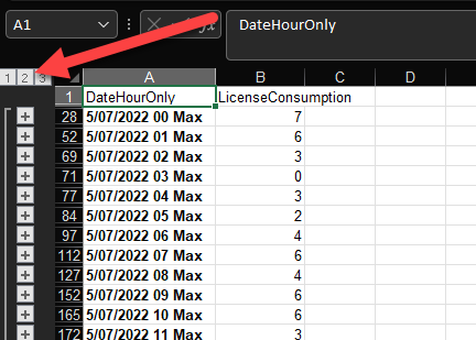

- After the Subtotals finish > select 2 in the Outline section to the left of the worksheet
- You will see a MAX total for each day's hour in your data -- this is the maximum number of licenses consumed during that particular hour in that particular day
- With Outline 2 selected showing the MAX values, place your cursor in the DateHourOnly label cell above the data
- Hover over the markers at the peaks > review the tooltip to determine the associated Date, Hour and Licenses Consumed value
- In this example, 5/11/22 in the 1700 hour is showing the highest peak of 52 licenses consumed
- In this example, as I hover over the peak markers across the chart, I can see that the 1600 and 1700 hours tend to be when the most licenses are consumed across the 90 day period I am reviewing
Additional Note: The horizontal axis in the above charts shows the row count for the series of Max totals. After much troubleshooting, I was unable to show the DateOnly or the DateHourOnly labels on the horizontal axis instead of the row count.
If anyone is a super Excel wizard, please feel free to comment and share how this may be possible!

Hi Katie,
Thank you for this article!
I have some questions for the "DateTime" column instructions:- Starting in the second cell of the TEXT_LoggedInAtUTC column (following the header), highlight the entire column down (Ctrl+Shift+Down Arrow) > Copy the data > Paste Values only under the DateTime column header -- this is so you copy the values over and not the formula
- Repeat the copy instructions for all of the data in the TEXT_LoggedOutAtUTC column (excluding the header) > Paste Values only in the DateTime column UNDER the LoggedIn data you just pasted in
So after these 2 instructions, does that mean the DateTime column is twice as long as the initial data? (since we are pasting all the logged in and logged out times into one column?)
Then the next instruction is to remove duplicates from this DateTime column. This is where I'm not quite following the rationale. What is expected from the result of removing all duplicates? Will the result be this column having equal amount of data (i.e. rows) as the original data? I guess I'm not understanding what is the intent/meaning of this new DateTime column when it is composed of the unique set of logged in and logged out times -- especially when removing the duplicate values from this column will not necessarily result in parity with the original data.
Apologies, if I am misreading or misinterpreting the instructions!
victorvictor0 -
@Victor Cheung - I apologize for the delayed response, I missed the email notification. Here are the answers to your questions below:
-- Yes, the column would now be twice as long in length as the original row count
-- The expected result is that there is only 1 unique value for any given login or logout date/time. There is a chance the original data does have multiple people logging in or out at the exact same date/time, but in order to obtain a correct calculation we only want 1 unique entry for any date/time value.
-- The result would probably not have equal amount of data (i.e. rows) as the original data. This would only occur if you had exact number of logins/logouts happening simultaneously which is not very likely.
-- The intent is to only have 1 data entry per date/time. If you had three entries for say, 4/14/2023 10:11 AM, then in the corresponding LogInCount or LogOutCount (whichever it falls under) would receive extra counts which would inflate your Running Sum numbers making it appear more licenses were consumed than in actuality.
-- It might be rare, but if your users never did overlap in login or logout date/times then when you go to remove duplicates there may be none. But the step is there to ensure there aren't any duplicate values that could inflate your counts.
I hope that helps clarify this step. If not, please feel free to reach out again or you can email me at khuckett@jamasoftware.com.Katie Huckett
