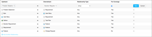

To add rules, select Add Rule Set then Add Another Relationship. The Upstream and Downstream drop down menus will list all of the items you have available in your Organization. The Upstream and Downstream columns will dictate which direction the items can be related. It is possible to create the same relationship in both directions using two entries. As mentioned above, the Relationship Type does not have any functional purpose. It is for differentiating types of relationships with a label.
When setting relationships, you will have the option to make it For Coverage by selecting the checkbox. When it is For Coverage it will allow the Relationship Status Indicator to trigger if a required relationship has not been satisfied or there is an orphan item. As of 2015.2 you will need to resolve all of the item's relationship needs as outlined in the Relationship Rules to toggle this indicator off. You will see one of the two below images in single item view indicating this depending on your version of Jama.

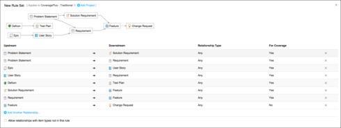

To add a project to a Rule Set, select Add Project next to the rule set's title. Multiple projects can share a relationship rule set to keep it consistent. One Relationship Rule Set can be assigned per project. Additional rules can be added to the existing rule set if more are required.
To edit a rule, select the rule you would like to change and it will become editable. Make the changes you wish and select Save to apply. To delete, select the X icon next to the rule.
The selection at the bottom Allow relationships with item types not in this rule will allow any item not listed in this rule set to be related with any other item not in this rule. It will not affect the existing relationship rules.
