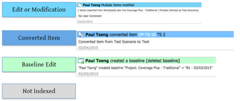

While working with the Activity Stream, you will notice that activities are labeled with specific colors to indicate a certain action.
 The gray bar will indicate that deletion; restore or change has not been indexed.
