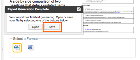

Replacing the blacklist with the whitelist will not impact users' experience with Jama in most cases. However, since ".html" file type is not in our whitelist, users can only Save the report in an html format and cannot Open it from Jama. If users click Open, the html report will still be downloaded.
Images in HTML output of reports that have a relative path will not show after saving the reports and opening them locally from users' computer. A relative path does not include the server address while. a full path starts with Jama server address. For example "/report/image/birtimage.jpg" is a relative path, and "https://support.jamaland.com/report/image/birtimage.jpg"; is a full path. This behavior exists in all versions of Jama and is not a side effect of using whitelist vs. blacklist. However, it may stand out once users have only the option of opening HTML report outputs locally. For example, images that are generated by BIRT reports have a relative path and users will not see them if they open the HTML open locally from their machine. The images that have a full path to their source will still show if the Image Security is not on.
You can still select the HTML format as output of a report, but the HTML file must be downloaded and images may not be visible. Jama is leaving the HTML as an option because it can be useful for testing reports.
If users want to Open the report outputs and also view images, we recommend changing the default output of the reports to Word or PDF instead of HTML. On-premises customers can make this change by following the below instructions.
Log in as Jama Admin > go to Admin page > find the report and click on Edit. You can select PDF and Word outputs in Reports Format instead of HTML. Our hosted customers need to open a Support Ticket to change the output of their reports.

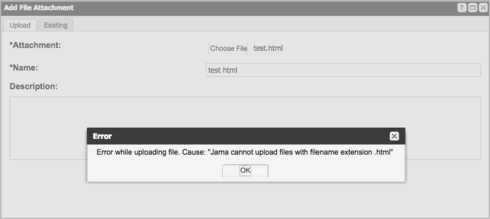

Existing attachments that are not on the whitelist will still be downloadable but will not be viewable in the browser. You will see the error message when trying to upload a file type that is not in the whitelist.

We have recently added HTMLHTML, and js to the blacklist of our hosted customers. This is due to some security concerns that allowing HTML and js files would cause. Users can potentially write code to extend Jama's UI. Allowing HTML and js file types opens up the possibility for a user to upload malicious code that extracts data.  We have no evidence that this vulnerability has ever been exploited, but we have blocked the possibility for your protection.
