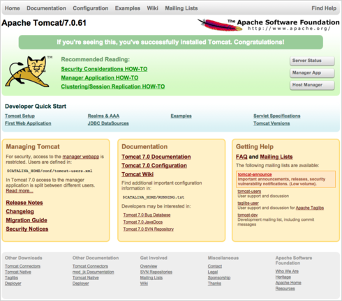

The first thing to determine is whether Tomcat is up and running. Normally when you try to navigate to the Jama home page, you enter a URL like http://my.tomcat.server:8080/contour.
  • Try navigating to the same URL minus the /contour. If Tomcat is running, you should get to the Tomcat homepage.
  • If you cannot get to the Tomcat homepage, make sure Tomcat is started and verify your Tomcat configuration. Tomcat support falls outside the scope of Jama support but you can refer to the Apache Tomcat documentation for additional information. Also, refer to our production system requirements page in the User Guide and verify you have configured your Java memory settings correctly.

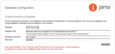

Database connection issues
Jama may run but you encounter issues while trying to connect to your database during setup. There are a variety of issues that can cause a database configuration to fail but the most common is a Generic JDBC Exception. The Generic JDBC Exception is cryptic.
For this type of error, the best place to start is in the contour.log file. In the logs, the most common errors you will see are related to being unable to open a connection to the database. This usually means there is something wrong with the configuration. In addition, take a look at the following:
  • If you are using Oracle, verify that the Oracle jdbc driver is located in the correct directory.
  • Verify that the URL to the database and/or the credentials used to access the database are correct. To do so, log into the database directly using the credentials you are trying to use for Jama. Perform this test from a separate workstation and the Jama server itself.
  • Verify that the Jama server can communicate with the database server using tools like ping or telnet. If you cannot connect to the database server from your Jama server using those tools, contact your system administrator for assistance.

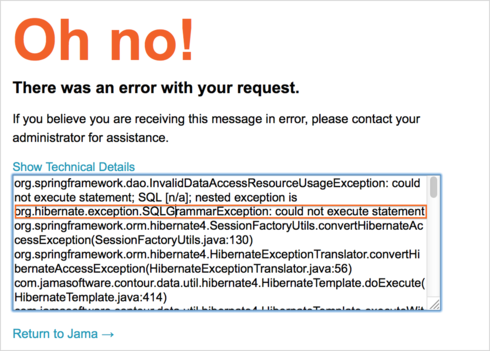

Oh no! page
If you see the Oh no! page while trying to configure the database, take a look in the technical details window. It may provide some useful clues.
The above error indicates that the user trying to access the database doesn't have edit permissions. Verify that the user connecting to the database has the correct level of permissions to the database as discussed in the user guide.
