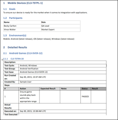

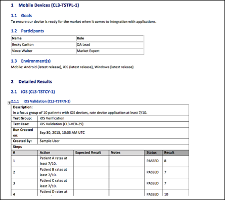

The Test Results Report (Test Cycle) gives test results grouped by test cycle.
The Test Results Report (Test Case) gives test results grouped by test case.

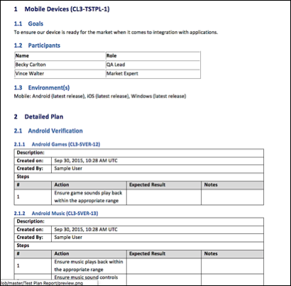

The Test Plan Report provides Test plan coverage complete with description, creation dates, creator name and steps.

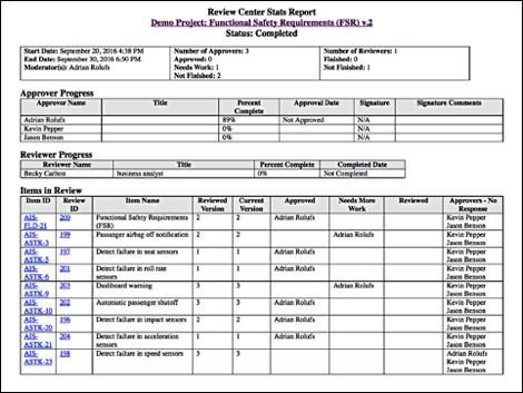

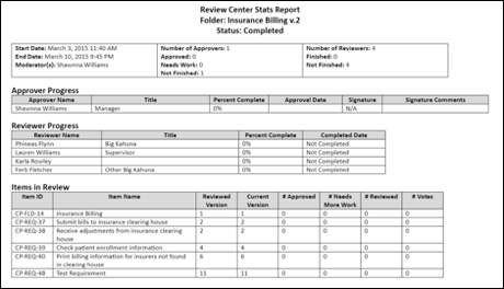

The Review Center Stats Report provides general stats of what is happening in the Review center within an organization.
The Review Stats - Reviewers Per Item Report presents a more detailed view on the individual items in review as well as identifying which Reviewers/Approvers responded, approved, reviewed etc.

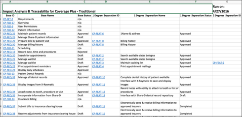

The Upstream Traceability Report provides for the export of upstream traceability coverage as an alternative to Trace View. Note that there are two versions of this report:
The original Upstream Trace shows six upstream levels of relationships, but is only compatible with versions of Jama Connect released prior to 2020 (due to changes to the Velocity engine).
Upstream Trace Two Levels version shows only two levels. We recommend the use of this report if you have a large number of items and find the original report takes too long to render.

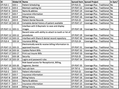

The Sync Status Report shows all items in any project that are synced with the selected items, along with their Sync Status. It can be run in HTML or Excel. One thing to note: this report displays all items that share the same Global ID with each selected item. If items are reused often, the report may take a long time to run. If this is the case, users may want to select smaller sets of items from which to run this report.

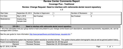

Review Center Comments will export current revision comments on open reviews. In order to run the report in a given project, the user must be assigned to one or more reviews in that project as either a reviewer, moderator, or approver. What this means is that when we load the list of reviews for the report parameter list, we load them based on the project you're in, and the user you're logged in as (so public reviews won't show unless a user is a reviewer, moderator or approver, even though they can look at the review itself).

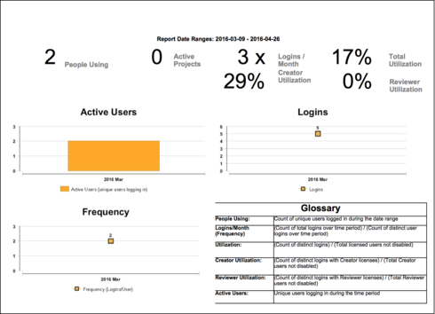

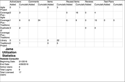

Utilization by Project displays the number of specific Jama objects (users, comments, reviews, etc.) used by a project over a selected date range.
Visual Utilization Report visually displays Jama Utilization data over a specified amount of time.

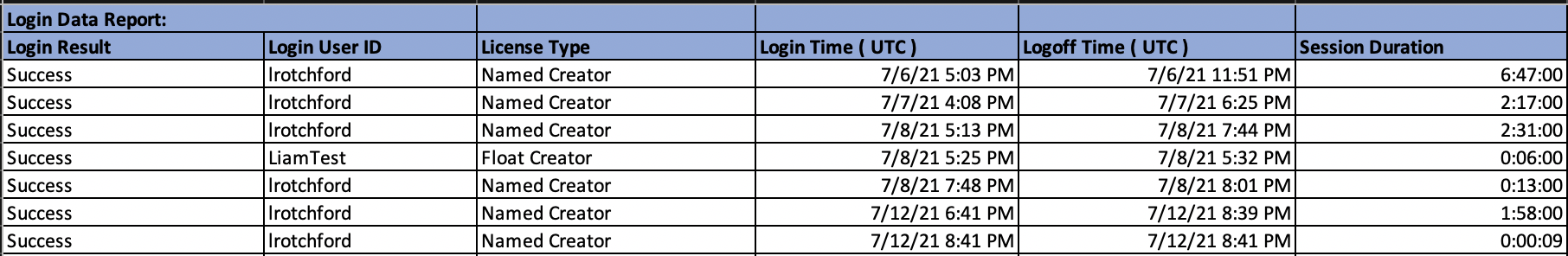

Login Data Report
This is a non-context sensitive report that builds a single sheet excel file of user login data over the past 90 days. The report gathers information such as the login attempt status, the login attempts username, the license type of said user, the login and logoff time in UTC time and the logged in session duration. The time duration of how far the report will check can be modified by adjusting the hours values on line 421.

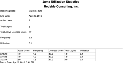

Usage Over Time/Utilization Over Time (2015.1) displays license usage information.
*This report does not work in Jama 8.36+ (will work up until that version.)

Regarding the Upstream Traceability report -- I've uploaded it to both a 2014.2 server and a 2015.1 server, and ensured that "Visible to Users" is set to "true", but in neither server does the report show up as an option in the Run Reports list when I have a set of items in context.
Am I missing something obvious?

Just heard about the Review Center Comments report on the Q&A webinar today.  Very excited to hear it existed.  Then learned that it was only available for version 2015.1 and I thought great, we're running version 2015.2, but then learned it works only on Java v8, but we can only support Java v7 currently, so how are we running Jama 2015.2?  Then learned there's a bug in Jama and we're really running Jama 2014.2, but then learned there were reports available for earlier Jama versions, and now see a version for 2014.1 but not for version 2014.2!  Say it isn't so, say it isn't so!  Is there not a RC Comments report available for version 2014.2 or v4.5.3 or build date 2014/11/20 17:24   ...I think that may be as specific as I can get re: our version.
05-29-2015 14:40
Note that we now have a Review Center Comments report available for hosted customers. (Yay!)

I've noticed status doesn't get resolved if it's an item type that can't have (upstream) relationships, such as folders. What item types are you seeing this on?
04-07-2015 12:58
For some reason. My report does not resolve Base Status or any separation.. Any idea why?
$docDao.getDocument($h2).status.name etc.
