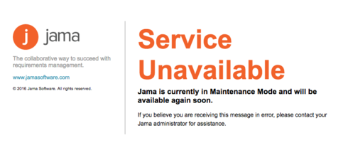

  • As of Standard 8.1 and Express 8.2, Jama will go into a maintenance mode during a full re-index. Users will not be able to log in to Jama during this time. Users who are already logged in will receive a pop-up message informing them of the maintenance. Be sure to notify users prior to initiating a re-index.

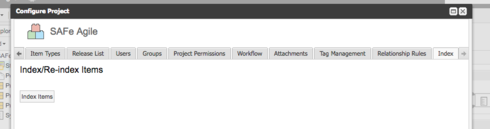

3. Log in to the System Administration Root menu.
4. Click on the Index/Search tab.
5. Click on the Index Items button.
