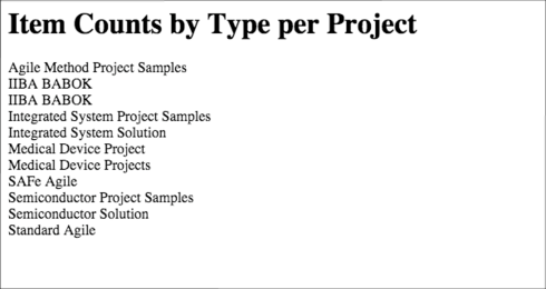

Step 2: List Projects
First, the report needs to list available projects in Jama. In Jama's Velocity Report documentation, the projectSource.getProjects() method returns a list of projects.
#set($projects = $projectSource.getProjects(true))
<html>
<head>
<title>Item Counts by Type per Project</title>
</head>
<body>
<h1>Item Counts by Type per Project</h1>
#foreach ($project in $projects)
$project.name<br>
#end
</body>
</html>

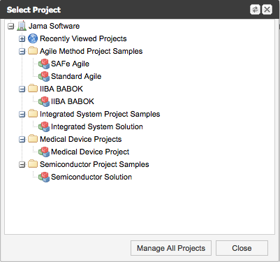

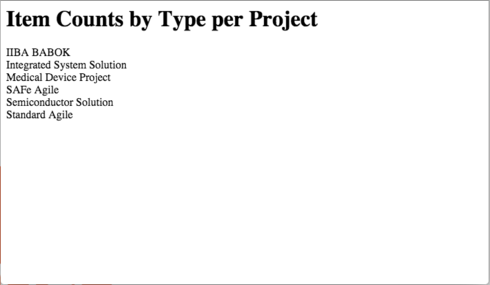

Step 3: Show Only Actual Projects
Some entries are showing up in the list twice, like "IIBA BABOK." In the Select Project window in Jama, projects can be arranged in Folders. The folders are the extra entries in the previous example.
For this report, the folders are not needed, just a list of projects. To fix that, check to see if each project is a folder, and only show it if it is not.
<html>
<head>
</head>
<body>
#if (!$project.isFolder)
$project.name<br>
#end
#end
</body>
</html>

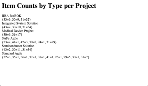

Step 4: Get Item Counts for Each Project
In Jama's Velocity documentation, documentSource.getAllItemTypesCount() returns a map object, which is a list of name/value pairs. In this case, the name is the Item Type and the value is the number of items of that type in a project.
<html>
<head>
</head>
<body>
#set ($itemCounts = $documentSource.getAllItemTypesCount($project.id))
$project.name<br>
$itemCounts<br>
#end
#end
</body>
</html>

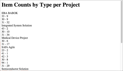

Step 5: Show Each Item Type on its Own Line
Each Item Type should be on its own line; the Velocity User Guide has an example of how to get keys (names) and values out of a map object.
<html>
<head>
</head>
<body>
$project.name<br>
#foreach ($itemType in $itemCounts.keySet())
$itemType - $itemCounts.get($itemType)<br>
#end
#end
#end
</body>
</html>

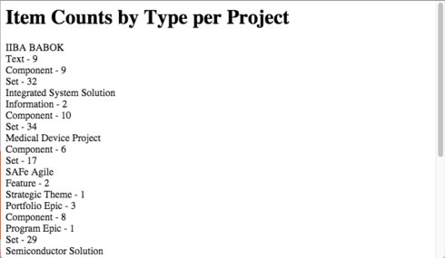

Step 6: Display Item Type Names Instead of ID Numbers
That is a good start, but the report needs the name of the item type instead of just the ID number. In Jama's documentation, documentSource.getAllDocumentTypesMap() returns a map object containing id/document type pairs in a given organization.
For each item type, get the name of the item type from the $documentTypes map, and the count from the $itemCounts map.
#set($documentTypes = $documentSource.getAllDocumentTypesMap(2))
<html>
<head>
</head>
<body>
$project.name<br>
$documentTypes.get($itemType) - $itemCounts.get($itemType)<br>
#end
#end
#end
</body>
</html>
Note: Another way to do this would be to make a documentSource.getDocumentType() call for each document type in the report. In a short report, this probably would not make much difference. In a report with many projects and item types, it could be considerably faster to get all the document types at once.
