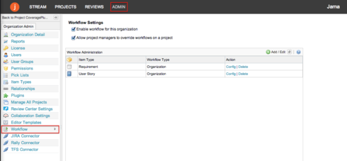

Setting up/enabling Organization Workflow
To set up Organization Workflow, go to
Admin > Workflow.
From this main page, you can access the settings for workflow, which include enabling the functionality for the Organization, and permission for Project Managers to override a workflow within a project. A list of currently active workflows is displayed beneath these settings.

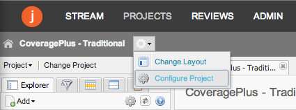

Any workflow created at the Organization level will be available to every project within that Organization. If the
Allow Project Managers to override workflows on a project box is checked, users with Manage Project permissions will be able to edit Workflows at the Project level to better suit their needs. To access workflow from a project level, click on the gear icon next to the project name in the top left, and select
Configure Project.
This will open a pop-up window. Select the
Workflow tab to see a menu of active workflows similar to the one located in the Admin Section. By clicking
Override, the Project Manager can make changes to but not delete the workflow.

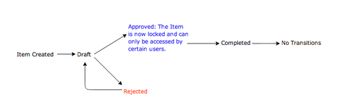

For our example, we will create a workflow for this business process:

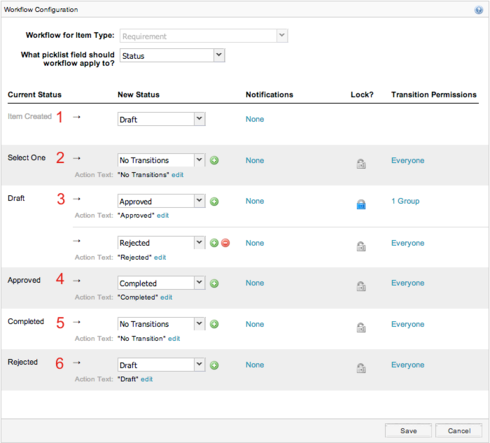

A Workflow that represents the above image would look like this:
Now to explain this Workflow process:

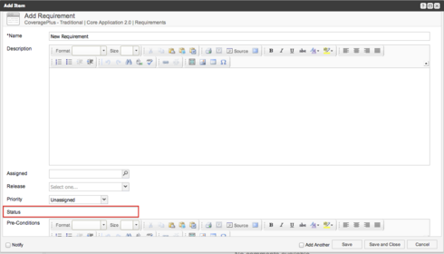

When a Requirement is created, it is mapped to the status will immediately be set as "Draft." If you were to create a new Requirement with this Workflow active, you would notice that the option to change the status is not available.
After creating a new Requirement, a small box will appear at the top right of the item window. Clicking on it will reveal the transition options available for the workflow. In the case of our example, a Requirement that is a Draft can go one of two ways: it can be Approved, or Rejected.

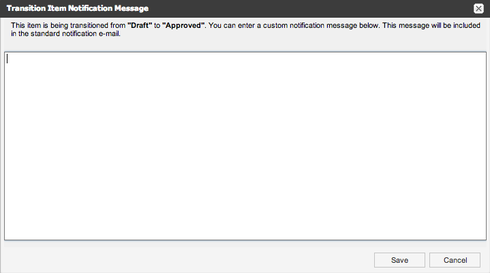

If the item was approved, a pop-up box will open giving users the option to leave a note about this transition.
If you notice #3 on the example workflow, it has been set so if the item is Approved it is automatically locked. This can be adjusted in either the Admin or Project Configuration Workflow menus, as well as notification settings.
After the Requirement is approved, it can be transitioned to Completed.
As it is set up in the example workflow, Completed Requirements have no further transitions available in the workflow. If a Draft Requirement is "Rejected," the only transition it can make it back to a "Draft" state. This can be changed to best fit your business process if need be.

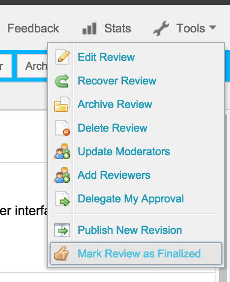

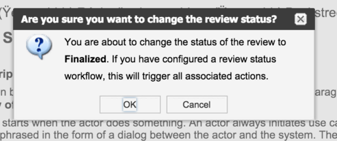

After a review is completed, it will need to be "finalized" in order for Jama to transition the statuses of the items. A "finished" review and a "finalized" review are not the same things; you will need to enter the review and manually change the status. This can be achieved under the "Tools" dropdown while inside a review. (Note: Only the review Moderator can finalize a review. It is possible for the moderator to revoke the finalization of the review if need be.)
After finalizing the review, the status of the Use Case has been changed to "Approved."
If the Review Status Workflow is set to update the item once the review is set to
Not Finalized, you must first Finalize it. Once
Finalized, you will see the option under Tools to mark as
Not Finalized.
A pop-up box will notify you of the changes that will be made to items belonging to this workflow.
