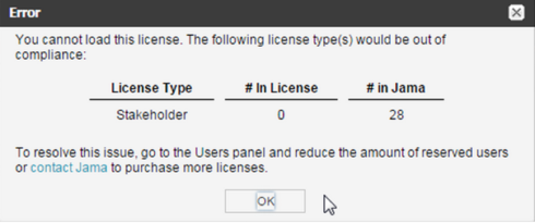

"Out of compliance" is a common error when trying to apply a new license key that contains different license types than what are currently in use. This error is displayed when users are assigned to license types that are missing in the new License.
Note: In newer versions of Jama Connect you may have users report an inability to login, but you will not see this error when the license is applied or synced.
In the above example, 28 users have Stakeholder license types assigned in Jama, however, the new License contains zero Stakeholder license types.
In order to upload the new License, these users need to be temporarily deactivated in the Admin > Users list.

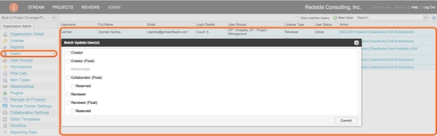

You can batch update the license types in Admin > Users, by shift-selecting the users > right clicking
 Batch Update User(s)
