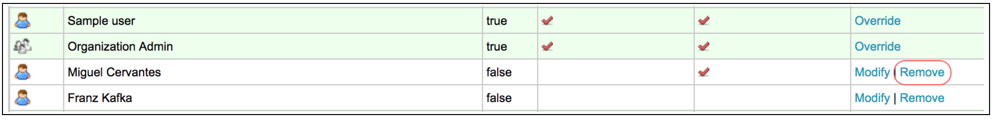

You can always remove an override, under the Permission > Actions column. That will re-apply the inherited permissions.
In case permissions have been granted only to that particular project's location, the inheritance is always set as FALSE and the Remove option will clear the Group or User from that container.
False/white vs True/green

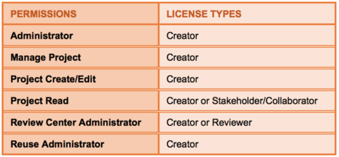

Permissions and Licenses
User's permissions must be aligned to the license type applied in order to work correctly.

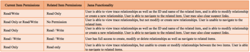

Permissions and Relationships trace
