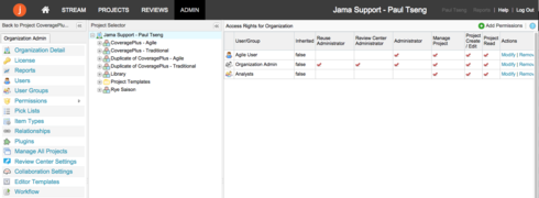

The screenshot below depicts the User Group permissions that have been set at the Organization level:
The groups that are depicted here will be present in each project within the Organization with the same inherited permission levels. However, you can create a group at the Organization level. This gives you the ability to remove it then pick and choose which project to assign the User Group to, if needed.

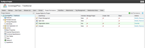

Alternatively, if you want to create a project-specific group you can navigate to Admin > Projects tab  > Select Project > Project Permissions > Add Permissions > New Group. The Project Manager also has the ability to do this through the Configure Project menu (shown below).

Inherited: Permissions for Users and User Groups are inherited from higher levels in the Organization/Project structure. For example, if you assign a group access at the Organization level, all Projects, Components, and Sets within the Organization will inherit the permissions. When a row contains the value "True" and has a green highlight, the group has received its permissions from a higher level. It is possible to override these inherited permissions by clicking Override to the right of the user or group.
Manage Project: Users with these permissions can manage permissions for the project, as well as create and edit items. Project Managers cannot add new users to their projects.
Create/Edit: Users with these permissions will be able to create and edit items within the project. Keep in mind that only users with Creator License types can create and edit.
Read: Users with "Read" permissions can only view items.
Actions:
  • Override: If the group or user has inherited permissions from the Organization level, Override will give you the option to customize those permissions for the project. By using Override, it is possible to remove permissions entirely.
  • Modify: Edits the permissions for the group or user.
  • Remove: Will remove the user or user group permissions entirely for that project, set, or folder.
