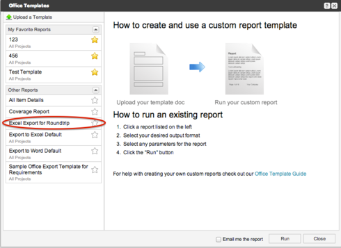

Go to the "Export" in the top right corner, and select "Office Templates".
This will open a pop-up window. Select "Excel Export for Roundtrip" and click "Run". Note: Round Trip is only available to be exported to Excel. Rich Text fields can oftentimes create difficulties within Excel and should not be used for Round Trip.
