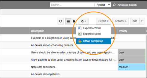

1. Navigate to Exports > Office Templates > Export To Word Default.

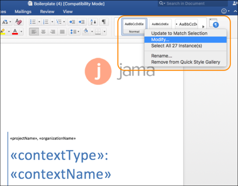

3. Open the Word document.

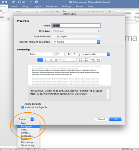

4. Right click on the Normal heading and select Modify.

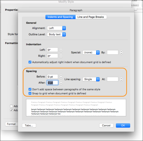

5. From the Modify Style window select Paragraph from the lower left drop-down menu.
6. Set Spacing configuration as below.
7. Select OK to save configuration changes.

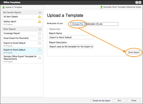

9. In Jama navigate to Export > Office Templates > Export to Word Default > Edit.
10. Point Jama to the edited boilerplate document by selecting Choose File and then select Save Report.
Now that the Export to Word Default export is saved, it is ready to use.
