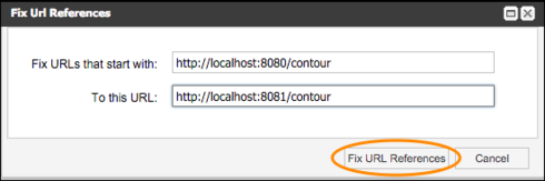

After changing the Base URL, the next step is to select the Fix URL References from the Action field which updates all URL references in Jama to the new value. If this step is not completed, Jama will still contain old URL references which can result in unpredictable behavior such as images not displaying in exports.
1. Enter the new URL in the To this URL text box.
2. Select the Fix URL References button.
3. Select Yes to complete.
