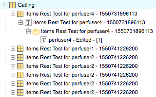

    HTTP Status 409 - Conflict Errors
    A 409 error is returned when the REST API attempts to modify an item that is already being updated. When adding/deleting or moving an item in Jama, there is a post-save process that updates the GlobalSortOrder for items in the tree. Jama uses this value to keep item hierarchy with their siblings.
    The Jama UI prevents this error by first locking the Item and then only allowing 1 user to modify it at a time. With the REST API developers need to handle this error with a short delay and a retry.
    When writing tests against the API, you need to eliminate 409 errors from your tests. The most common cause of these errors is having multiple users creating items in the same folder. Under load, you run into timing issues where multiple items are created at the same time and try to update each other. One item wins and the other gets a 409.
    Like we discussed above, any errors (even with a retry) will change the dynamic of the test. So, the best practice is to structure the test scripts, so each user creates a unique folder for their tests.
    At Jama, we put all tests artifacts into a single component. Each user creates their own component and structure (Set, Folder and then items). We also use a datetime stamp so we can tell which artifacts from different test runs apart.
