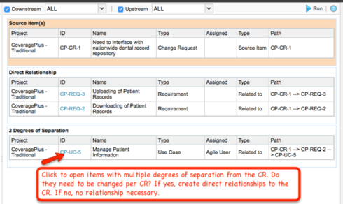

View Impact Analysis
Once relationships have been established, the Change Owner runs Impact Analysis reports and determine with colleagues whether or not to move forward on the CR.
Analyze Impact Analysis Report
As there are multiple layers of traceability, any given CR could have a large “ripple effect.” The Change Owner needs to review every item in the impact analysis to determine if they need to change per the CR
  1. If Yes, create a direct relationship in Jama from that item to the CR
  2. If No, move on to the next item
The end result of this analysis effort will be that all impacted items should have a direct relationship to the CR.

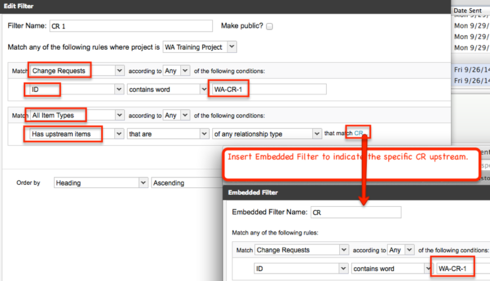

Create CR Filter
The Change Owner will now create a filter in Jama that shows the CR and all items related to the CR that need to be changed. This will provide a quick reference to these items to quickly baseline and send impacted items for review to stakeholders.

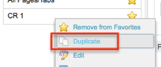

If an existing CR filter already exists, users can simply right-click to duplicate the filter and just change the CR # reference in the filter criteria:
Now Change Owners and stakeholders have a filter to easily see and baseline items related to the CR:

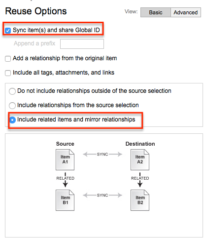

Option 2: Reuse
This is an alternative option to simply using a baseline. Using Reuse, the Change Owner can actually create a physical branch in Jama. This branch can exist in a separate area of the tree or in an entirely separate Jama project.
This approach requires more manual processing but is beneficial in that the mainline requirements remain unchanged while a separate branch is edited and reviewed. This is helpful if other work such as testing is going on in parallel while the requirement changes are under consideration.
To Reuse, right-click the CR and choose "Reuse."  Make sure you click the option to "Include Related Items and Mirror Relationships" This will ensure you are copying the CR and the related requirements.  You may also choose to create Advanced Reuse rule to handle any special circumstances in your item structure.

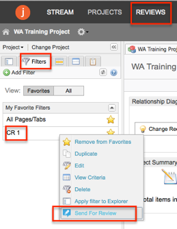

Find the relevant CR and Send for Review.
For Option 1 - Branch with Baseline you may right-click the CR filter to Send for Review.

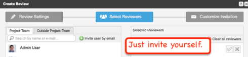

To begin, set a deadline, optional settings, and just invite yourself for the first iteration of the review. This will allow Jama to baseline the requirements to be included in the review and give you a chance to see how the Review will appear to your stakeholders. Later, you will publish a new revision of the review with the proposed updates and include stakeholders for feedback.

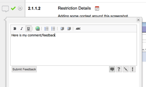

5 Facilitate Stakeholder Review
Stakeholders will receive an email notification to participate in the CR review. When they open the review they see the “proposed” requirement changes but can easily see a side-by-side comparison to the baseline version of the requirement:
Stakeholders may add comments, mark items as reviewed.
