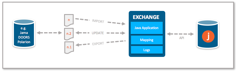

Jama-to-ReqIF Data Exchange
Data Exchange for Jama Software can be utilized to share requirements information with customers, vendors, systems integrators, suppliers, etc. who are utilizing other requirements management tools in order to improve the efficiency of collaboration.As an example, an automotive components manufacturer is collecting product requirements from their customers. To eliminate the need for redundant documentation and requirements gathering efforts, Data Exchange for Jama Software is used to import requirements information that is authored by the customer in their requirements management tool. After the initial import, the development team uses Jama to review and make changes to the requirements.
Upon completion of the review and update process, the customer requirements are exported out of Jama back to ReqIF, and sent back to the customer. The customer imports the updated requirements into their requirements management tool and generates updates and reports as necessary. This exchange process continues throughout the development of the customer product, keeping both the supplier and customer teams informed and up-to-date about modifications without the need for additional documentation, external messaging, or other integrations. When the ReqIF file returns to Data Exchange for a follow-up import into Jama, the existing Jama Items are updated and versioned appropriately with the new changes (instead of creating duplicate items during each new import).
Jama-to-Jama Data Exchange
Data Exchange for Jama Software can be used to share information between disconnected instances of Jama. This is especially useful when one or both Jama environments are running in an air-gapped network configuration and traditional integration platforms are not feasible.
Migrations
Data Exchange for Jama Software can also be used to migrate the information within an existing requirements management tool to Jama as a one-time migration.

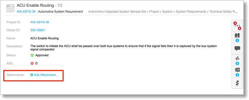

  1. The Attachment widget must be enabled on the Component item type. Data Exchange uses this to persist metadata for the integration.

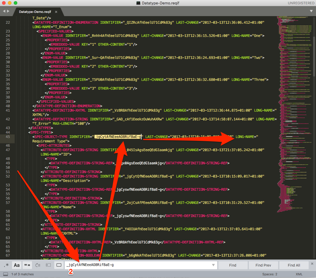

The mapping file contains a set of instructions for creating and maintaining a mapping of ReqIF SPEC-OBJECT-TYPEs and SPEC-RELATION-TYPEs to specified Jama Items and Relationship types within a given Jama instance. This mapping is necessary for Data Exchange to understand how information should translate the project information across tools.
Mapping Operations
For each SPECIFICATION-TYPE mapping, 4 parameters must be specified within each mapping operation:
  1. operation - mapSpecificationType
  2. reqifSpecificationTypeIdentifier - SPECIFICATION-TYPE identifier (string)
  3. legacyIdFieldName - A custom text field name used to support round-trip exports (string)
  4. fields - An array of field mappings, each containing the following attributes:
    • reqIfAtttributeName - The long name of an attribute (string)
    • jamaFieldName - A Jama field name (string)
For each SPEC-OBJECT-TYPE to Jama Item type mapping, 5 parameters must be specified within each mapping operation:
  1. operation - mapItemType
  2. reqifSpecObjectTypeIdentifier - SPEC-OBJECT-TYPE identifier (string)
  3. jamaItemTypeId - A Jama item type identifier (string)
  4. legacyIdFieldName - A custom text field name used to support round-trip exports (string)
  5. fields - An array of field mappings, each containing the following attributes:
    • reqIfAttributeName - The long name of an attribute (string)

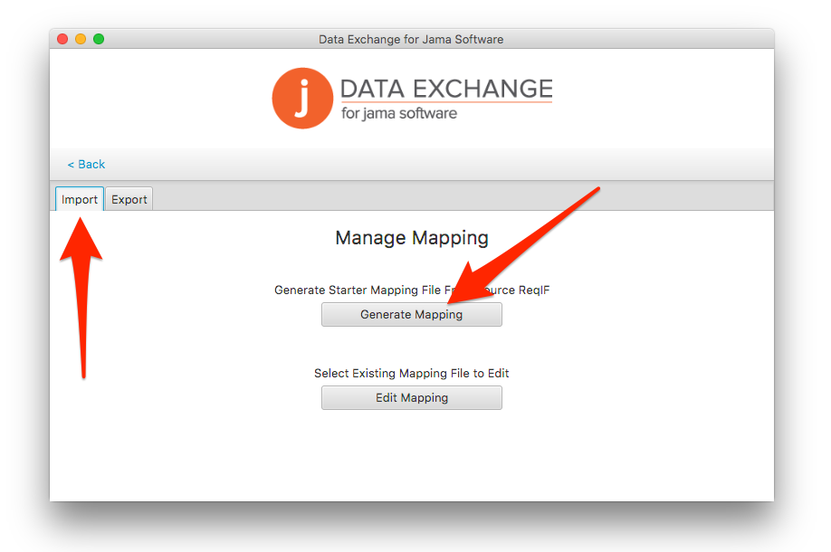

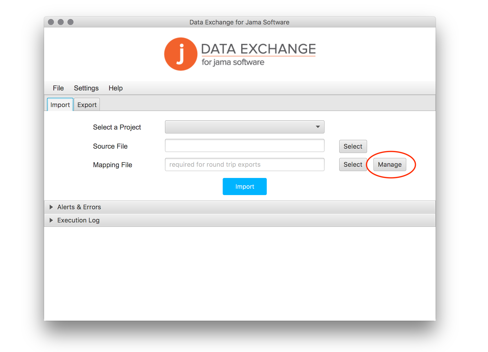

  1. Open the Mapping UI by clicking the manage button on the right side of the mapping file field.Click the manage button to open the Mapping UI
  2. Click the Generate Mapping button.

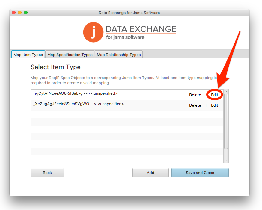

  4. For each Item, Type click the edit button to configure mapping for that item.
    Select Item Type Screen
  5. To configure an Item Type, first decide what Jama Item Type the ReqIF item type will map to. This can be accomplished by copying the ReqIF Object Type string and searching for it in the ReqIF source file. Find the <SPEC-OBJECT-TYPE> with the IDENTIFIER that matches the ReqIF Object Type string displayed in the Data Exchange. Use the LONG-NAME and <SPEC-ATTRIBUTES> to decide which Jama Item type is an appropriate match. Select the identified item type from the dropdown menu.
    Map item type screenReqIF Searching
  6. Optionally select a Round trip ID from the dropdown. "legacy_id" is the default name used for this.

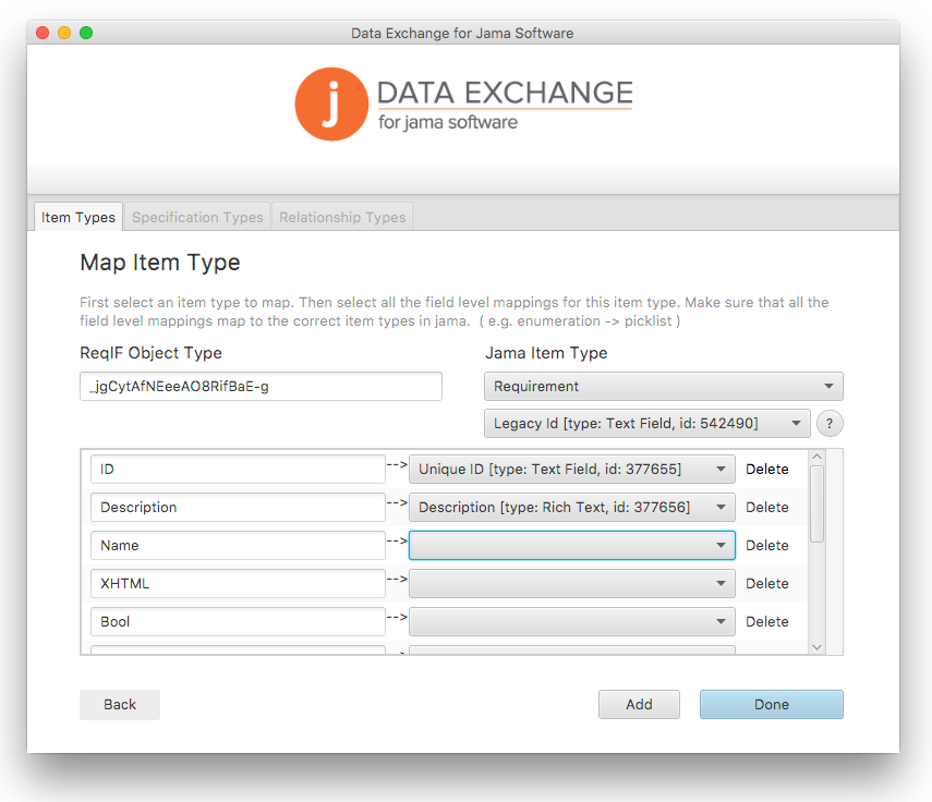

  7. For each ReqIF attribute listed in the left column, select a Jama Item Type field to map to from the drop down box in the right column. The field chosen must have a compatible data type with the ReqIF attribute. The ReqIF attribute data type can be determined by looking in the ReqIF file at the <SPEC-OBJECT-TYPE> identified previously. Within the <SPEC-OBJECT-TYPE> element will be a <SPEC-ATTRIBUTES> element that contains a number of <ATTRIBUTE-DEFINITION-<some data type>> by identifying the attribute definition that has a matching "LONG-NAME", you can determine the data type of the ReqIF attribute.
    Map Item Type Screen
  8. Click the Done button to apply these mappings.

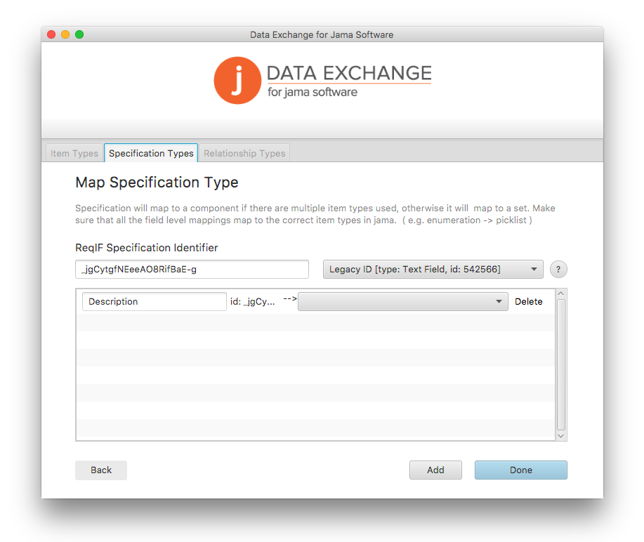

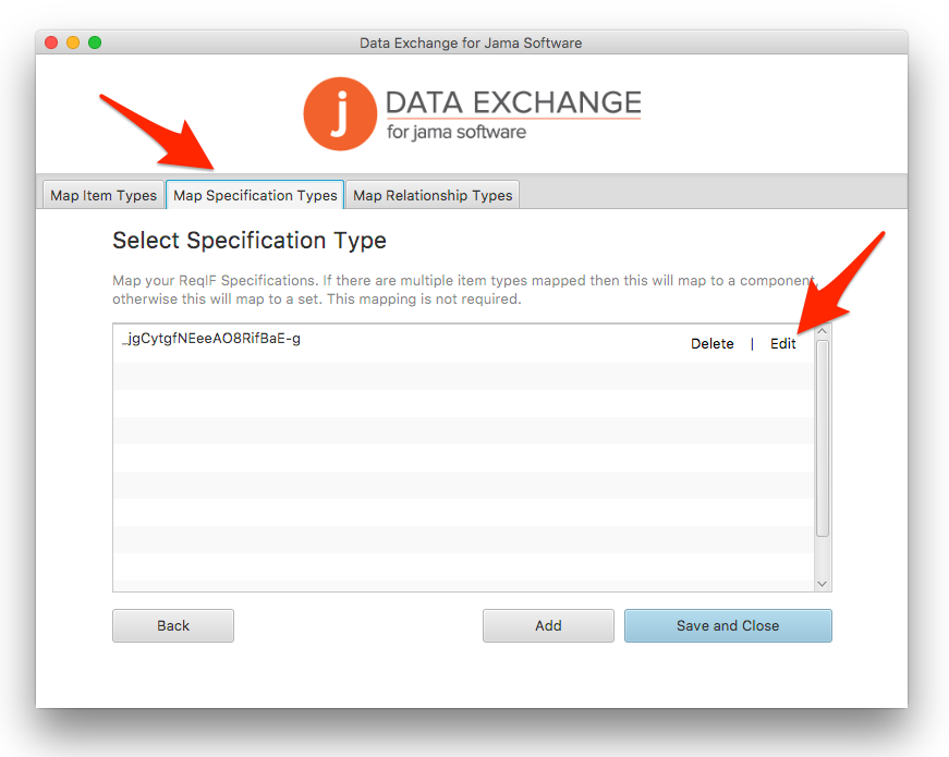

  9. Click the Specification Types tab. For each Specification Type, click the Edit button to configure the mapping for that specification.
    Select Specification Type
  10. Optionally select a Round Trip ID from the dropdown box. Map any fields that are to be imported.
    Map Specification Type

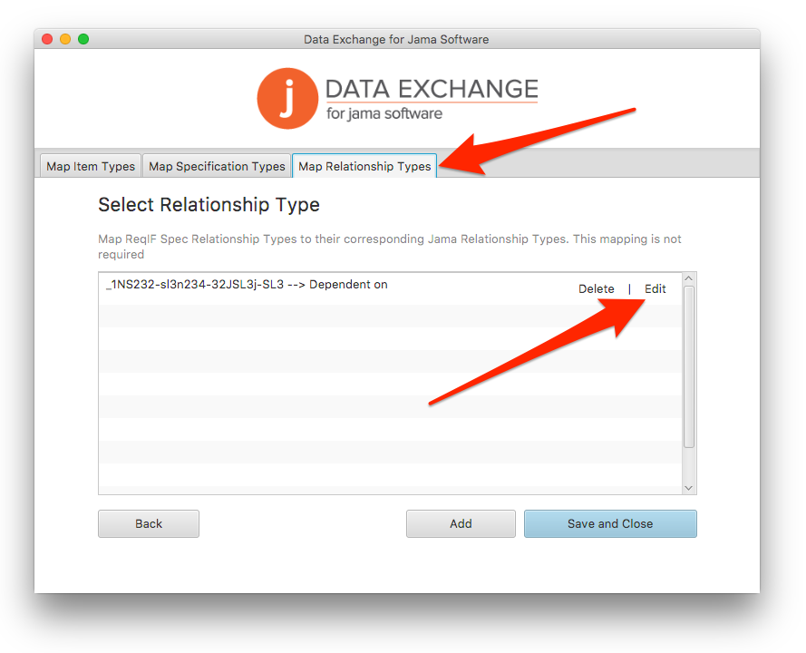

  12. Click the Relationship Types Tab.
  13. For each relationship type click the Edit button to configure the relationship.

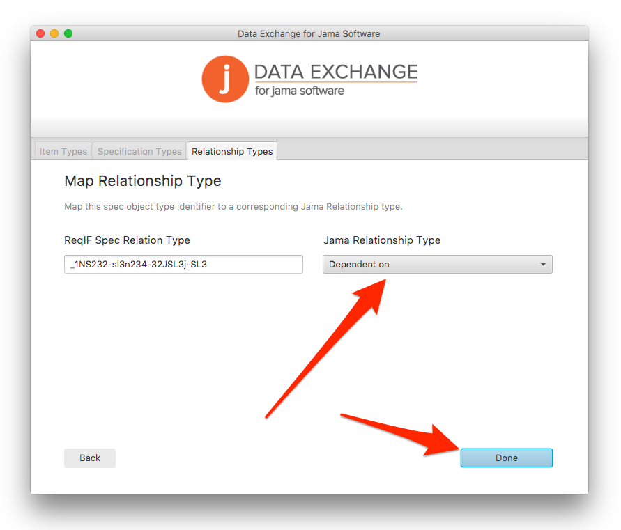

    Select Relationship Type
  14. Select a Jama Relationship type from the dropdown menu on the right and click Done.
    Map Relationship Type
  15. Click on the Save and Close button when you have finished configuring all of your items, specifications, and relationships. A file save dialog will open, choose a name for the mapping file. A .json file extension will automatically be applied if omitted.
  16. Congratulations you have created your first mapping file from source. Use the Select button to the right of the Mapping File text box to select the file you have just created.

The following table shows how ReqIF's attributes definitions map to and from Jama's field data types
ReqIF Attribute Definitions Jama Field Data Types
Boolean Flag
Date Date
Integer Integer
Real Text Field or Text Box
String Text Field or Text Box
Enumeration Pick List *
XHTML Rich Text
* When configuring the pick list to map between an enumeration, make sure that all the ReqIF "Enum Values" have corresponding Jama pick list values to associate to. Make sure that that each picklist option's "Display" field exactly matches the Enum Value's "long-name" field.

A mapping file with field mappings pre-configured based on an existing ReqIF file can be generated. This generated mapping file will include all of the
SPECIFICATION-TYPEs, SPEC-OBJECT-TYPEs (Item types), their ATTRIBUTES (Item type fields), and SPEC-RELATION-TYPEs (Relationship types) found within the specified ReqIF file, as well as placeholders for the user to fill in the necessary Jama configurations for mapping.There are 4 Jama-specific attributes in the mapping file that need to be configured:
  1. legacyIdFieldName - This field is specified as ‘legacy_id' by default, but can be configured to support a custom text field name, as required.
  2. jamaItemTypeId - For each ‘mapItemType' operation, the ‘jamaItemTypeId' attribute must be configured.
  3. jamaFieldName - For each field mapping, the ‘jamaFieldName' attribute must be configured.

Jama Item Attachment Widget
Files attached to Jama Items via the ‘Attachment' widget on Items are not supported by Data Exchange for Jama Software due to structural limitations in the ReqIF standard.
It is recommended that users embed attachments within the Rich Text Editor. Disabling the Attachment widget on Items within the scope of exchanged Components may mitigate user confusion between the available methods (the Attachment widget is still required on the Component Item type to enable round-trip functionality through Data Exchange).

  • Disable the attachment widget on Items to ensure users do not add attachments that cannot be exported (However, attachments on Component item must be enabled because Data Exchange stores ReqIF metadata required for round-trip functionality on Component attachments).
