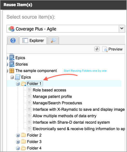

  • Avoid reusing large numbers of items. In order to reuse a container (i.e. Component, Set or Folder) start with the lowest level container, whether it is a Set or Folder, and reuse each sub-component one-by-one.
If the lowest level component has a large number of items, use the list view and reuse items in a smaller batch (e.g. 50 items instead of reusing all of them at once). A safe number for reusing items in a batch may vary based on the specifications of the Jama application server, the database server and the database type and configuration. Given the varying degrees of data complexity, system configuration, and Jama usage, it's difficult to put an exact recommendation on an upper boundary for Reuse and Sync. Our 2015.2 release includes optional notifications to warn users when a Reuse could impact performance. The in-app alert will be appear when users initiate a Reuse or Sync of more than 250 items. Users have the option to permanently dismiss this message, as they may not be experiencing any issues environment.
