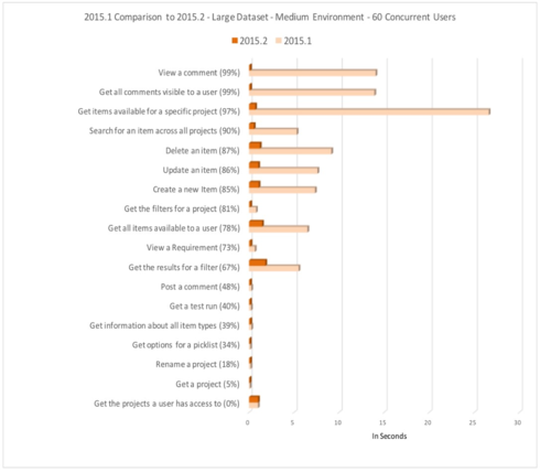

Jama 2015.2 showcases significant performance improvements that have been made to achieve considerable impact on the performance of large-scale deployments. These sections compare the results of Jama’s performance tests run against a large instance of Jama 2015.1 as our baseline vs. the Jama 2015.2 version. This information can be used to compare the results to an implementation of Jama to better predict the potential improvement may be expected from upgrading to Jama 2015.2.
Baseline Comparison:  This overall test plan consisted of a series of isolated test actions that serve as the baseline set of response times for Jama 2015.1 that could be used as a comparison to the response times for the same test actions in Jama 2015.2.  Other factors such as environment settings, dataset content, and the number of concurrent users were kept static across both test runs to ensure reliable and measurable test results.
The following chart represents a comparison of average response times between 2015.1 and 2015.2.  These tests were run with 60 concurrent users performing isolated actions using our representative large dataset and AWS (M3 2XL) test environment.

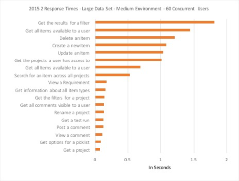

The following chart represents the average response times observed while testing the 2015.2 version of Jama.  These tests were run with 60 concurrent users performing isolated actions using the representative large dataset and AWS (M3 2XL) test environment.
Note:  The average response time for each of these common actions occurs within 2 seconds.
Performance Test Conclusions
·  While performing these isolated test actions in Jama 2015.2 against our large dataset and medium system environment we generally saw more than a 50% gain in response times as compared to Jama 2015.1 for commonly used functionality.
·  As outlined in the summary tables above, the improvements made in 2015.2 provide significant benefits for the common user actions within Jama.  This includes searching for items, creating items, filtering items, and posting comments.
·  The performance gains achieved with the 2015.2 release are consistent with the performance optimization work done during the release.  These changes included improvements for permission calculations, caching, chattiness, hibernate listeners, review center optimizations, synchronous calls, and other general refactorings.
·  While running these tests we monitored performance KPI’s for CPU utilization, memory utilization, throughput, and load averages which all remained in target thresholds for optimal system health.
