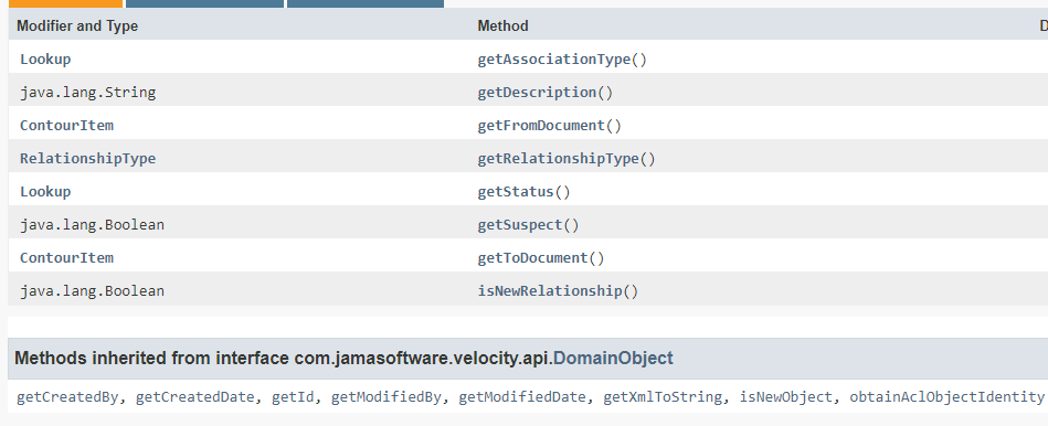

The text at the left shows the type of object that is returned (DocumentDocument in this example). Clicking on the object link will show the returned object's methods:
Don't forget about the inherited methods at the bottom.
