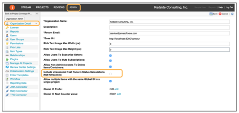

Under the Administration Organization Detail panel, there is an option to "Include Unexecuted Test Runs in Status Calculations".
https://higherlogicdownload.s3.amazonaws.com/JAMASOFTWARE/BlogFiles/41fc955c-43c1-4f8f-a146-e989521b42b2/RackMultipart20151120-26060-1t2uyii-Screen_Shot_2015-11-20_at_9.57.08_AM_inline.pngBy default, this calculation setting is checked for existing and new organizations, and unexecuted test runs are included in the calculation. To include only executed test runs in the calculation this flag needs to be unchecked. However, this is not retroactive.
*It is important to note that if you generate a Test Plan report, the Test Case Status in that report will be based on the most recent run in any plan, not that plan specifically. You would need to archive a test plan if you do not want the status of its runs to affect the Test Case Status.
