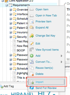

After you have filled out your spreadsheet to your liking, you can import it into Jama. This can be done from two locations: from the project menu at the top of the Project Tree, or from right-clicking the desired set or folder.
From atop the Project Tree:
From the desired location:

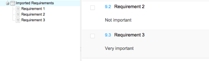

When you use the layout above, your import will look like this in the Project Tree.
Example Import

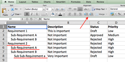

Excel's indent option allows users to specify hierarchy within Jama for the items being imported.
Above, you can see that the indentation hierarchy has been used in the "Description" column, which the user must specify from the pick list on the left. If a user had indented cells under the "Name" column, the user would choose "Name" from the pick list.
Example Worksheet
Here, indentation has been used under the "Name" column with 3 tiers of hierarchy.
Note: the Excel "Increase Indent" button should be used for indent. Using keyboard spaces won't work.
Example Import
After importing a spreadsheet using indentation, the items will appear like the following in the project tree.

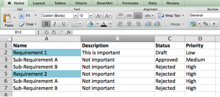

Excel's cell coloring option allows users to designate item hierarchy upon import.
Above, you can see that the cell color hierarchy has been used in the "Name" column, which the user must specify from the pick list on the left.
Example Worksheet
In the below example, each colored cell contains the parent items and all subsequent items will be the child items.
Example Import
NOTE: The cell coloring hierarchy method only allows 1 tier of hierarchy and does not differentiate between colors.
