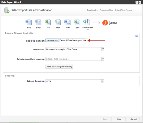

Step 3: Find and Select the File You Want to Import

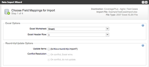

The first step of the importing wizard is choosing the field mappings --
Excel Worksheet and Header Row: You are given the option to select which worksheet of your Excel document you would like to import from, as well as which line that you have your headers on. In the example shown above, the headings are located on row 1, which is the row that is selected in the Import Wizard.
Round Trip is a feature available for items previously uploaded to Jama that can be batch-edited offline, and imported back into Jama to update the changes made to those items.

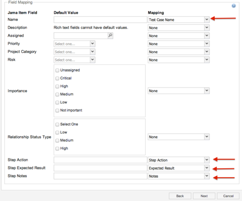

The Field Mapping area has many item fields for customizing details of the item you are importing. All of these can be mapped from an Excel document, however our example will use only four fields, marked with red arrows in the picture below:

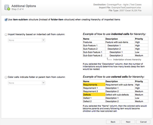

Step 5: Set the Hierarchy
The "Item-subitem" box will be checked by default and is what we will be using for our example. Should you need to use hierarchy in your Excel imports, you can do so by indenting or coloring cells.

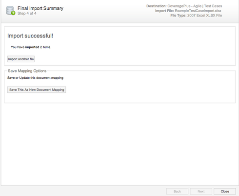

Step 6: Submit Your Spreadsheet

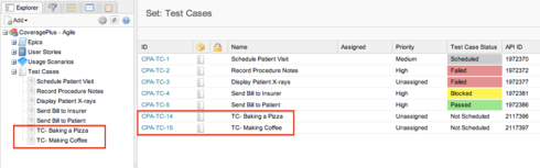

You should now see your imported document in your project.
