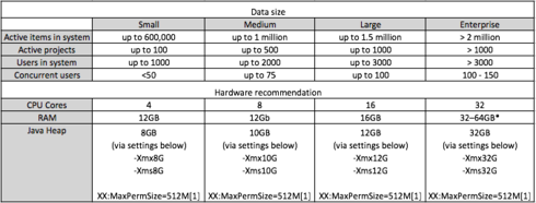

Required System Specifications (system requirements)
*32GB is sufficient for most systems unless memory-intensive workflows are common. If your organization consistently uses these workflows in an Enterprise-sized environment, 64GB is recommended. These memory-intensive workflows include bulk changes such as Reuse and Batch Update; Move Items; and item exports or reports with large numbers of items.
