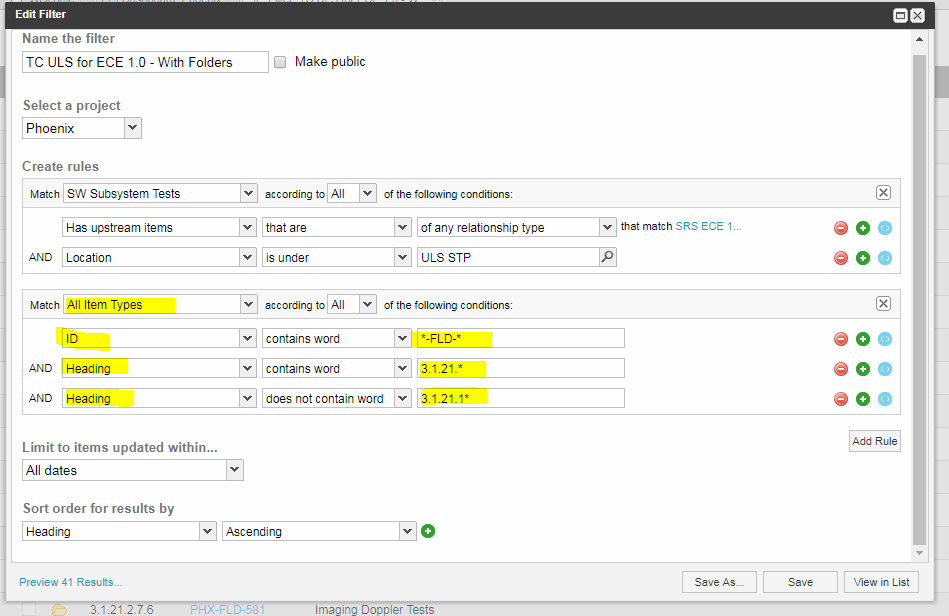

    My company is new to Jama and I've been struggling with this too. I've found 2 fields especially helpful - ID and Heading.
    In this snapshot I'm exporting some tests and the folders that are in a similar location. Notice that in the test part of the filter I can use "Location" because I'm filtering on one specific item type. In the folder part of the filter I have to use "Heading" to achieve a similar purpose since I'm matching all item types.
    One obvious drawback is that if you insert any sections before this one, causing the headings to be renumbered, the "Folder" part of the filter will break.
    I haven't used this much yet so I'm curious to hear your thoughts and experiences.

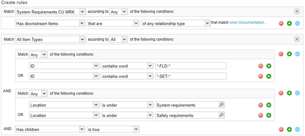

    The possibility to use the ID in combination with *-FLD-* or *-SET-* + the usage of the heading- and/or location-fields is a nice work-around. However, the work around has still some disadvantages. Let me explain in an example.

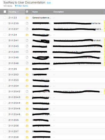

    We have some project, where we are interested on exporting particular requirements that live in only some folders in our structure. Therefore, we use a filter to query them (see following picture).
    When applying the filter, we have many empty folders that we would need to manage "by hand".
    We could use the heading to pick up only the relevant folders, but this is
    1. Time consuming, if you have a big amount of requirements
    2. Not easy to maintain, if the structure has sporadically small changes
    3. Is therefore error prone
    There are other, more automated work abounds, like reuse the containing structure, then filter on not-relevant-elements, delete them and finally exporting the remaining elements.
    If you compare this work around or the usage of Heading with the simple feature (e.g. a standard option on the filter window) of including antecessors on a filter, I think we can all agree that the last option is the more elegant and user-friendly one.
    @Jama-team: If you are interested in knowing in detail what we are trying to achieve and why is this feature relevant for our processes, we could make a web-conference.
    Side note: I previously worked with rational doors in the automotive industry in my previous firm. There we used this feature (include antecessors) in almost all filters. I would even dare to say that this feature was essential in our systems engineering and specification processes.
    Thanks one again in advance for your help.

    Thank you for these visuals, upon closer inspection of the filter you provided I am wondering if the "empty folders" situation you are describing may be coming from excluding any items which do not have children?:
    I was testing in my instance and when I used this as an "AND condition", it filtered out the folders which had child items but, left out the child-requirement items themselves. From reading your replies I am understanding that you are wanting both the folders and the child items? If so, I would recommend taking this rule out of your filter and see if this gets you closer to your goals. Let us know!
